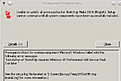

    Have installed wine 1.6 & SketchUpMake-en.exe
    Attempt to run Sketchup failed. Hence this message.
    Popup Screen Message:Click image for larger version
Name:	Skertchup Make2014.bmp

    Am not sure, but should I have installed 32 bit wine?
    did you install it frome in wine (wine tricks)
    or DL the .exe and install though wine ?
    installing the one in the wine tricks install applications works better IMO
