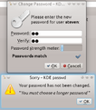

              This shows my attempt to change my password in System Settings in Account Details. It shows how my 2 letter password was rejected.
              According to your instructions, can you see what I did wrong? Thanks.

                In a konsole, I entered ~sudo kuser. When kuser opened I believe it was in root. I selected 'edit' and selected 'change password', typed in the current password, then typed in and verified my new password. There were no warnings about the size or rejection, so I Logged out and back in. The new password did not work, but the one I want to remove worked.
                I then restarted the computer thinking maybe it was necessary to reset the Root Password. The new password was still rejected, and the one I want removed worked.
                When the Operating System opened, only the unwanted sudo command worked.
                I am sure it is a mistake on my part, but I don't understand what I may have done wrong. Thanks!

                    su isn't the same as sudo; its password--as noted in my instructions--is root's password. (Of course your password, which is used when you sudo, could be the same as root's password.)
                    The second entry for su was using my old 2 letter password, that I would like to return to, and it opened the konsole in Root. This is backward to what was expected.
                    [ATTACH=CONFIG]5114[/ATTACH]
                    If you follow my instructions exactly it'll work.
