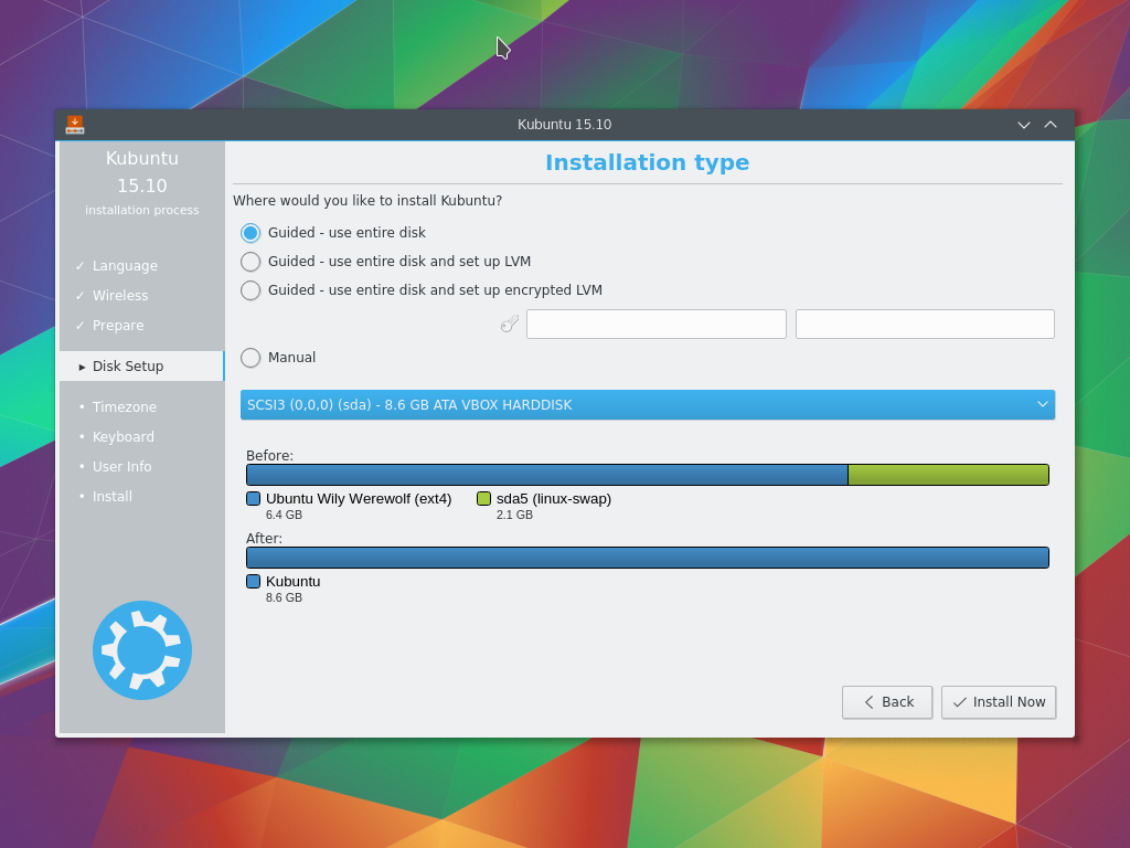

    I was going to attempt to re-install the OS saving home and keeping MS7 on the one partition but then I got to the point where it talked about partitioning. I always choose other but I don't do it often enough and didn't know how to proceed and keep all current partitions --- just re-install the OS.
    I kept seeing that at one time Ubuntu has or had an option during install to just reinstall. I don't think I ever saw that option on kubuntu live CD. It would be a nice option. Kind of like inserting Windows disc to repair something gone wrong.

    It's not clear to me what you're asking. If it's "How to do a new install over a previous install?" you can choose "Manual partitioning", select the correct partition for the root ("/") install and chick the "format" tick-box, select the correct partition for /home but DON'T tick the "format" box and install. This assumes you already have /home on a separate partition. If not, things can get a bit more complicated. You'll have to give more specific details in that case - start with your current partition layout.
      Complete guide using "Manual partitioning" (Something else method) here:
      https://ubuntu-mate.community/t/inst...lse-method/651
      As oshunlur stated above, click on "Manual" and DON'T FORMAT HOME!.
