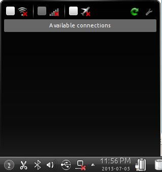

    So, I've lost my wired network connection in network Manager. Used to be, when I plugged in an Ethernet cable, it would just connect. Now, Nothing. Nada. Zip.
    Tried recreating a Wired connection, but still no go.
    All the wifi connections still show up, just Wired ain't working. If I turn off wifi, I get ... nothing.
    Any ideas?
