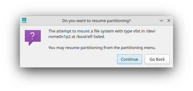

    After pressing Install Now the following message appears:

    The "biosgrub" partition would be used by a BIOS/GPT install, but there's a EFI system partition. That's confusing to me, and I think the installer is confused too. In 2022 we should be leaving the 1980s BIOS behind.
    Maybe you booted the Ventoy device in BIOS mode? How different computers boot in BIOS or UEFI mode differs a lot; you may have to choose a different boot option to get a UEFI boot.
    Do you want to keep the Manjaro installation, and dual boot with Kubuntu? It appears not, since you're formatting the only partition Manjaro could be on. If so, I suggest wiping the device first, maybe using gparted from a live session. Or choosing the "use the whole disk" option.
