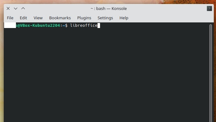

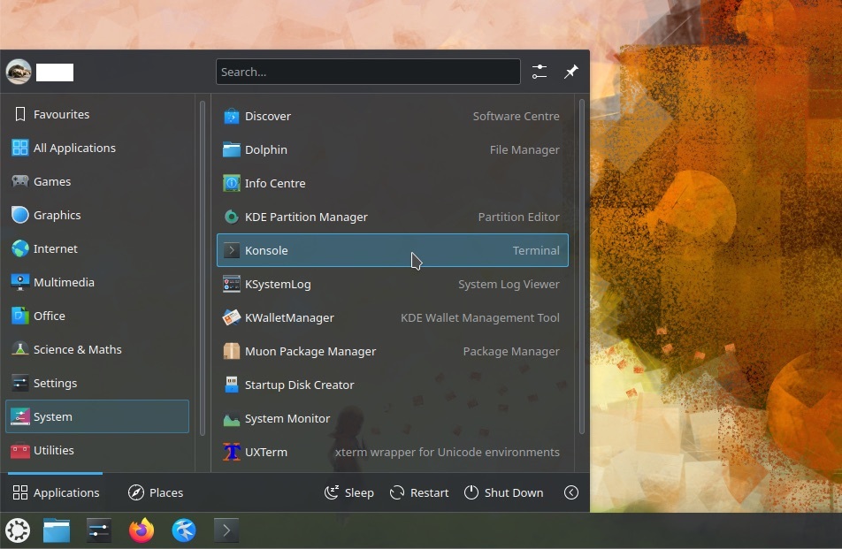

                Perhaps this is easier to understand:
                Click image for larger version  Name:	konsole_1.jpg Views:	0 Size:	157.1 KB ID:	672631
                Click image for larger version  Name:	konsole_2.jpg Views:	0 Size:	20.6 KB ID:	672632
                After pressing [Return] in the second screenshot LibreOffice should launch and then you can open the files from the "File -> Open" menu in LibreOffice.
                Leave the Konsole window open and proceed as written above.
