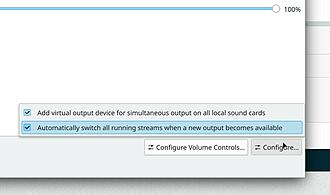

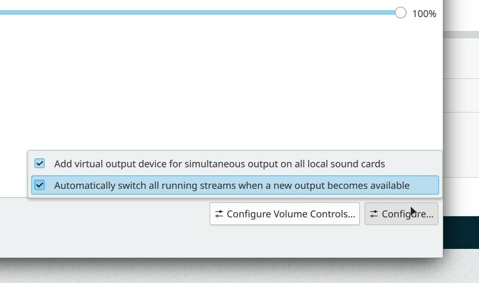

    Try turning this off (un-checking)
    Click image for larger version  Name:	Screenshot_20230420_161034.jpg Views:	0 Size:	51.2 KB ID:	670187
    It's in System Settings > Audio > Configure (lower right corner)
      That is already off.
