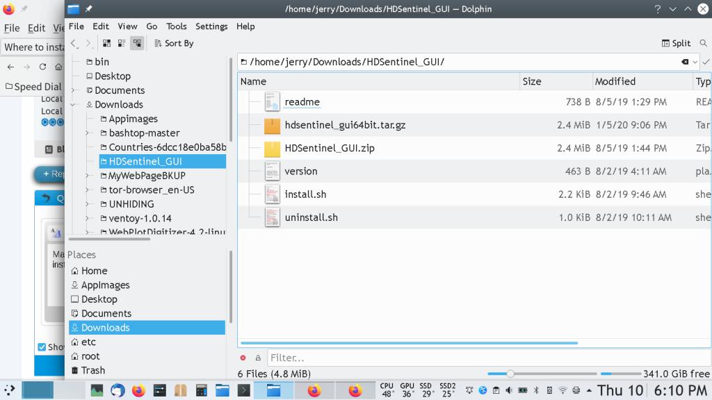

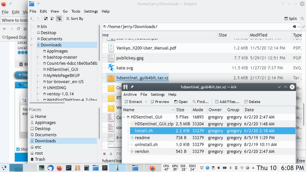

    Many tarballs, once untarred, include either an install script or instructions to use the make command. If Webstorm contains either then they will direct the install. I downloaded a tar file of HDSentinel_GUI in order to keep track of my TWB for my two SSD drives. I used Dolphin and browsed to Downloads and click right mouse on the tar file and chose "Open in Ark" from the list of options presented. The tar file, as listed in Ark, showed:
    You can see where the files are. Below is what is in the tar file:
    It shows an "install.sh" script and an "uninstall.sh" script. If you delete this directory after you installed the app in the tar file and later decide to delete the app you will have yourself a problem trying to locate the files you need to delete. That's why you keep this folder containing the untarred package ... it has the uninstall script.
    Since HDSentinel_GUI's install script was pre-coded to install the app files in specific cases the uninstall script knows where to find the files it should delete. IF your tar file used the make command against a "config", usually by issuing "make install". Later, if you want to ininstall the app you'd go to that folder containing the untarred package and issue "make uninstall".
