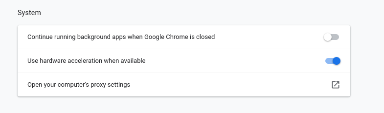

          I suspect strongly you had the chrome browser running. It doesn't exit after you close the last window, and installs to start when you log in. I just checked my 20.10 and after exiting Firefox memory usage was 690 MiB, with postgresql running.
                    chrome://settings/system
                    has an option to turn off "Continue running background apps when Google Chrome is closed".
                              Likely...yes. There is an option under settings to disable this ... ahem ... 'feature'. However it is set to 'on' by default.
