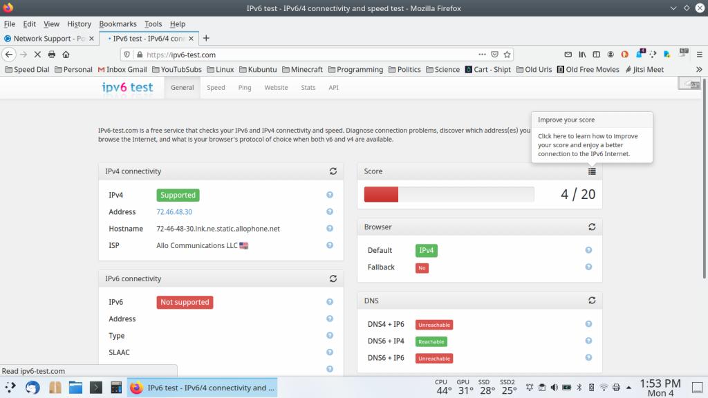

    My Hurricane tunnel has been so reliable over the last several years that I seldom go to IPv6-test.com to check on it. Today, I remembered that I hadn't checked it in a while and when I did I got
    Surprised, I navigated to a list of websites that only show in IPv6. Those that were still active displayed nicely.
    PS: I also uncommented
    net.ipv6.conf.all.forwarding=1
    in /etc/sysctl.conf.
    Using http://ds.testmyipv6.com/ I learned that both IPv4 and IPv6 connectivity works. The "ds." prefix checks to see which protocol is default. Before, my browsers demonstrated IPv6 preference over IPv4. That setting was browser independent because I didn't have to change any settings in a browser to have it default to IPv6. Somehow, a setting has changed and IPv4 is now the default protocol. I compared my /etc/gai.conf file from a year ago, before 20.04, and nothing has changed.
    My tunnel config hasn't changed either.
    Any network experts out know where the setting is to fix this?
