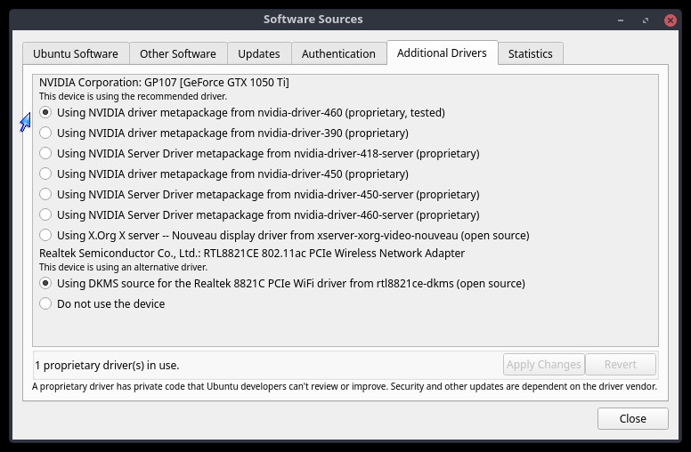

          In KDE Neon it was as simple as running
          sudo software-properties-qt
          from a Terminal and letting the system search for the correct driver.

              Wasn't it previously called software-properties-kde?
                Sort of. That was/is the name for the repo management tool. The driver manager used to be separate and called Kubuntu-driver-manager before it was redone as a tab in software-properties. Now it can be used in Lxqt (lubuntu) instead of a Kubuntu specific system settings module.

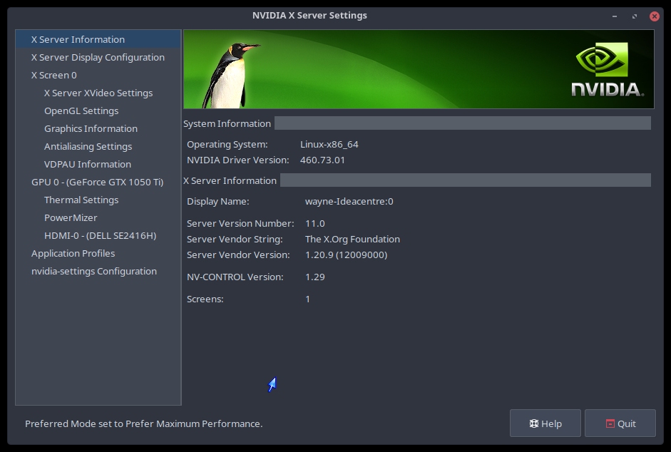

                    My only gripe is having to set Powermizer to maximum performance after every boot (for X-Plane 11)
                      Run this at startup:
                      #!/bin/bash#
                      # This is a bash shell script to be run at startup
                      # Set performance mode of GPU to 'maximum'
                      nvidia-settings -a "[gpu:0]/GpuPowerMizerMode=1"
