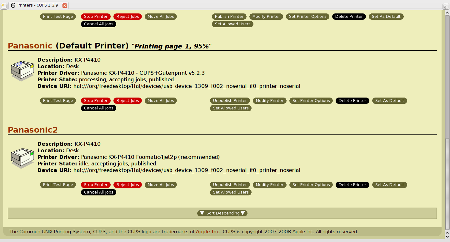

              The printer is working here. Cups has two defined printers for it, and both work. I opened CUPS and test printed both.
