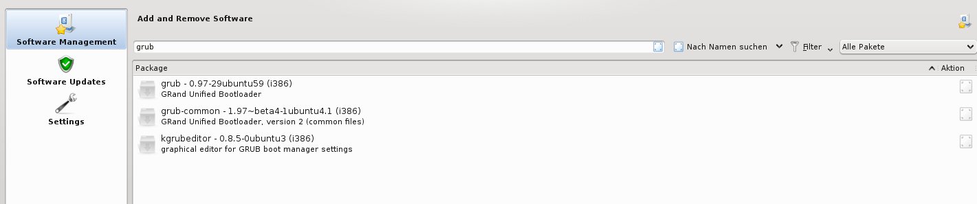

                These edits will let you boot the new kernel.
                But, there is something wrong with your system if sudo update-grub is not updating it -- I'm not sure about your configuration since you seem to have some part of legacy grub on a 9.10 system which normally installs Grub 2.
                  Re: kernel update problems
                  on my system is following installed, see attatchmend
                    If your only concern is to boot the new kernel, the edit I showed above should take care of that.
