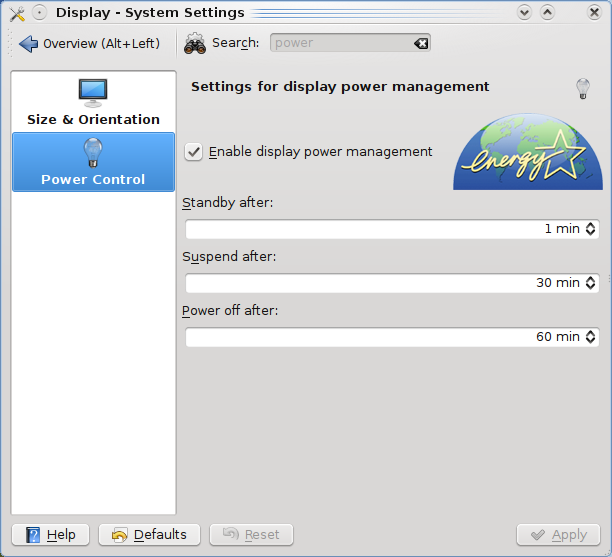

        Mmm, I just checked, it seems like DPMS and Power Devil are complementary. I see no option in Power Devil to shutdown the display. Why don;t you enable DPMW in the Screen section, just set it like in the screenshot to test and wait a minute, it will hopefully go off!

          I disabled 'Power Devil' and only enabled the power saving features in the 'Screen Saver' but sadly, I get the same result. The screen will standby and suspend (not that I can tell the difference) but it won't turn off!

            OMG, you _are_ right! I'll post before I go bad to bed (my kis is ill too!). If I set all three to be 1 minute I get standby, but not power off in my Rosewill Monitor. I think we should file this as a bug in Launchpad if we have time. Let's post here so we (and potentially others) can report in the bug.
