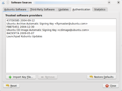

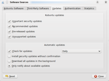

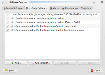

    Note that you should use Kpackage, the Add/Remove Software function in the KDESystem Settings. The "Settings" menu has the "Edit Software Sources" button that leads you to the dialogue boxes I posted below.
    Applying the GPG Keys for the repo is a hassle. Some folks say it is not needed, but my install ran smoother with them. I think I used this guide, or similar:
    http://siking.wordpress.com/2009/02/...s/#comment-122
    Note that you can add the repo for Amarok 2.1 too:
    deb http://ppa.launchpad.net/kubuntu-ppa/backports/ubuntu jaunty main
