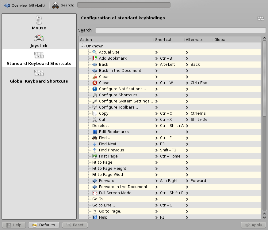

                              I realise I'm posting to an old thread, but Jim's error finally got to me.
                              9.04, no <System Settings>, <Keyboard & Mouse>, <Keyboard>
                              No idea why Jim and I are missing this 'feature'; I installed fresh from a 9.04 live-cd obtained in May.
