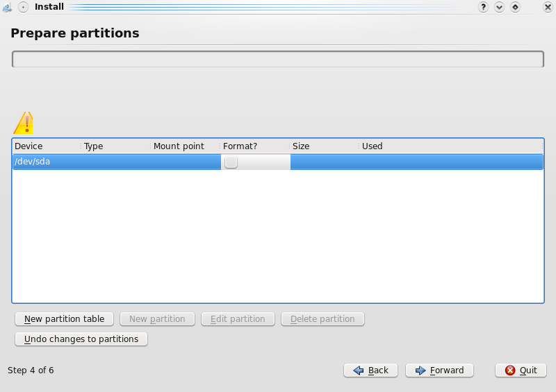

    so I decided to install kubuntu 9.04 via the live cd . but it doesn't detect the partitions , it suggests to use the entire disk , I tried the manual partitioning but the problem persists . (I attached a screen shot)
    here are the partitions : "
    ubuntu@ubuntu:~$ sudo -i
    root@ubuntu:~# fdisk -l
    omitting empty partition (5)
    Disk /dev/sda: 160.0 GB, 160041885696 bytes
    255 heads, 63 sectors/track, 19457 cylinders
    Units = cylinders of 16065 * 512 = 8225280 bytes
    Disk identifier: 0x84aa84aa
    Device Boot Start End Blocks Id System
    /dev/sda1 * 1 4972 39937558+ 7 HPFS/NTFS
    /dev/sda2 4973 10199 41985877+ 7 HPFS/NTFS
    /dev/sda3 10200 19457 74364885 f W95 Ext'd (LBA)
    /dev/sda4 15436 17135 13655218+ b W95 FAT32
    /dev/sda5 10200 15435 42058107 83 Linux
    /dev/sda6 17136 18974 14771736 b W95 FAT32
    /dev/sda7 18975 19457 3879666 82 Linux swap / Solaris"
    I need help with this
    please tell me if you have any suggestions about both problems (grub re-installation/disk scan)
