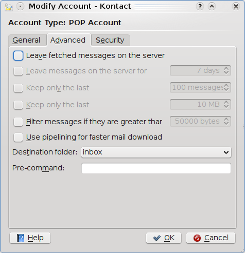

    Hi
    I have just installed Kubuntu 9.04 desktop rc(2009-4-16)
    I cannot find in "kmail settings" any button to instruct the isp to remove my emails from his server after I have downloaded them
    (was using kubuntu 6.06, which had it somewhere. 6.06 now all gone!)
    Thanks
    Re: kmail-remove emails from isp server
    kmail -> settings -> configure kmail... -> accounts -> receiving
    select account
    then click "modify"
    it's there.
    iirc...
    if you use pop3, i think you'll have to instruct it to leave the messages on the server.
    pop default is to delete the message.
    if you use imap4, i think you'll have to instruct it to delete the messages from the server.
    imap default is to keep them there.
    cheers.
    gnu/linux is not windoze
      Great help jankushka! In particular, look in the Advanced Tab
        thanks to both of you. I found it under "advanced". The default is not to leave it.
