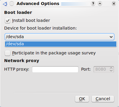

                          I'm using Kubuntu Jaunty Beta and I've noticed the same problem. The "Advanced" button at the lower right corner shows a drop-down menu with a single option: /dev/sda (which installs GRUB to the MBR). If I choose not to install GRUB, the files /boot/grub/stage1 and /grub/stage1 are not generated, making it hard to restore GRUB later on. I couldn't find the folder /usr/lib/grub/i386-pc either.

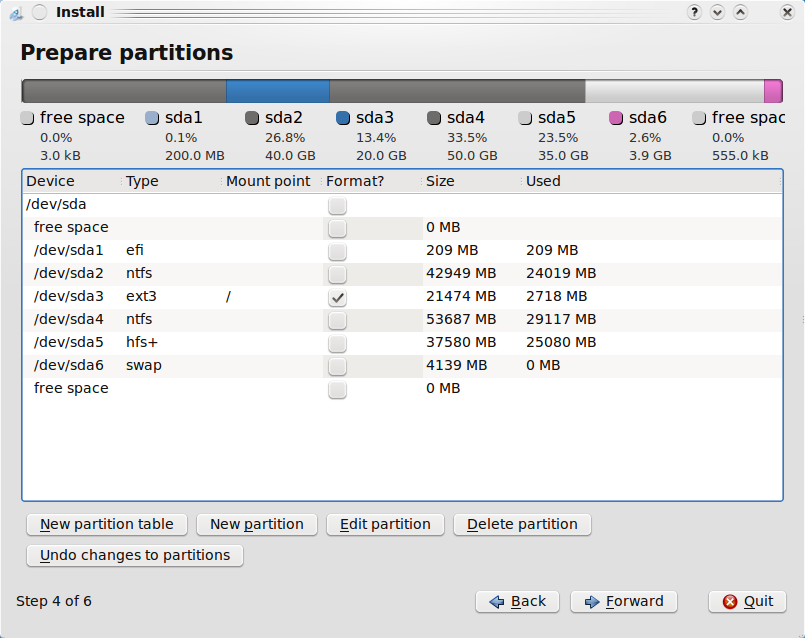

                              Qqmike, thanks for the help. I decided to take a few screenshots to prove my point...
                              The first screenshot shows my partition table, which has quite a few partitions. As you can see, I was trying to format /dev/sda3 as ext3 and use it as the Linux root partition. My swap partition is /dev/sda6.
                              The second screenshot shows the advanced installation options. The drop-down list is open and shows a single option for boot loader placement (/dev/sda). Notice that the list uses Linux notation instead of GRUB notation.
                              There's a chance this issue is specific to my hardware (a second generation MacBook), but I had no problem with Hardy or Intrepid. Do you think I should open a bug in launchpad?
