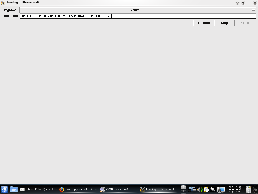

            Ok, I have messed around a bit & got the computers to see each other.
            I go to:
            settings/samba network browser/samba config
            and I see both the linux computer & the windows computer.
            I click on the windows computer & all shared folders show up
            I click on my movies folder then select a movie to watch, double click on the movie and this pops up (see attachment)
            I just want to play my movie.
            Can anyone tell me how to do this?
              Re: Networking with Windows problems PLEASE HELP!
              This looks like the default player is xanim and it seems to be making a local copy in /tmp. You can try other players. If you right click you may get some Open With options. You could install things like
              kmplayer, kplayer, mplayer or vlc. vlc is pretty good.
