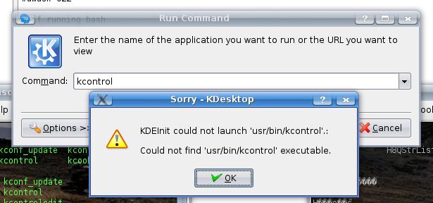

    Okay, looking for answers to the problem I first reported here.
    Running kcontrol from Alt+F2 results in a KDEinit error saying it can't locate usr/bin/kcontrol
    I can run it from Alt+F2 if I provide the path as /usr/bin/kcontrol so I believe it's a problem in a control file where the path to kcontrol is missing the leading /
    Running kcontrol from a console works. As provided in the post above, my system path is correct.
    Anyone else experiencing this? If so, did you fix it, and how?

          Re: kcontrol problem with Alt+F2
          Still hoping for some insight and a fix. This is my path as results from a konsole with echo $PATH
          /usr/local/sbin:/usr/local/bin:/usr/sbin:/usr/bin:/sbin:/bin:/usr/games
          This is what happens when I attempt to run kcontrol from Alt+F2
