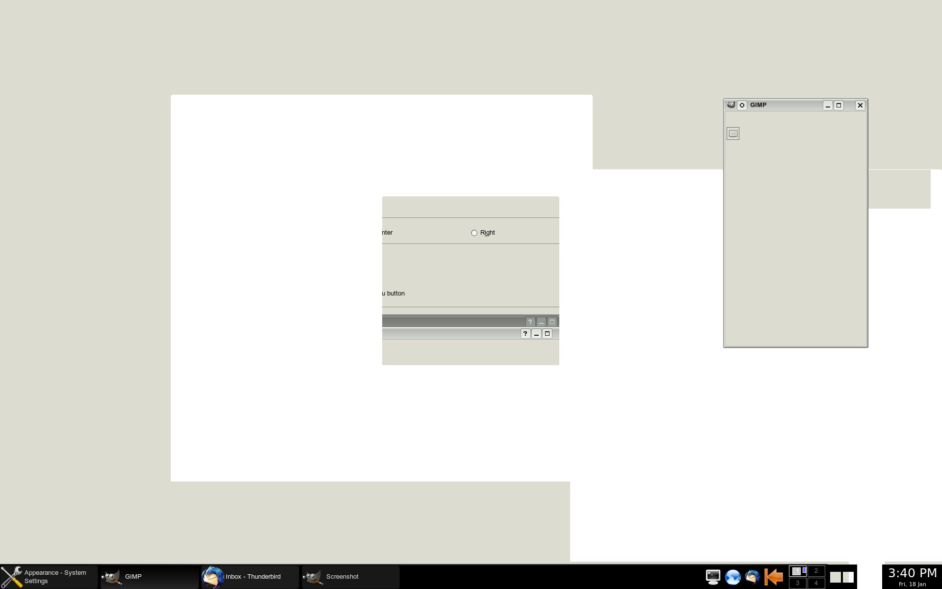

            WHoa, ok, I logged back onto kde4 and somehow got it to come up. I think I held down ctrl-alt and then wiggled the mouse. wtf?
            Anyway, now I dont have wallpaper, and the desktop isnt updating right...
            I attached a screenshot, hope it comes through
