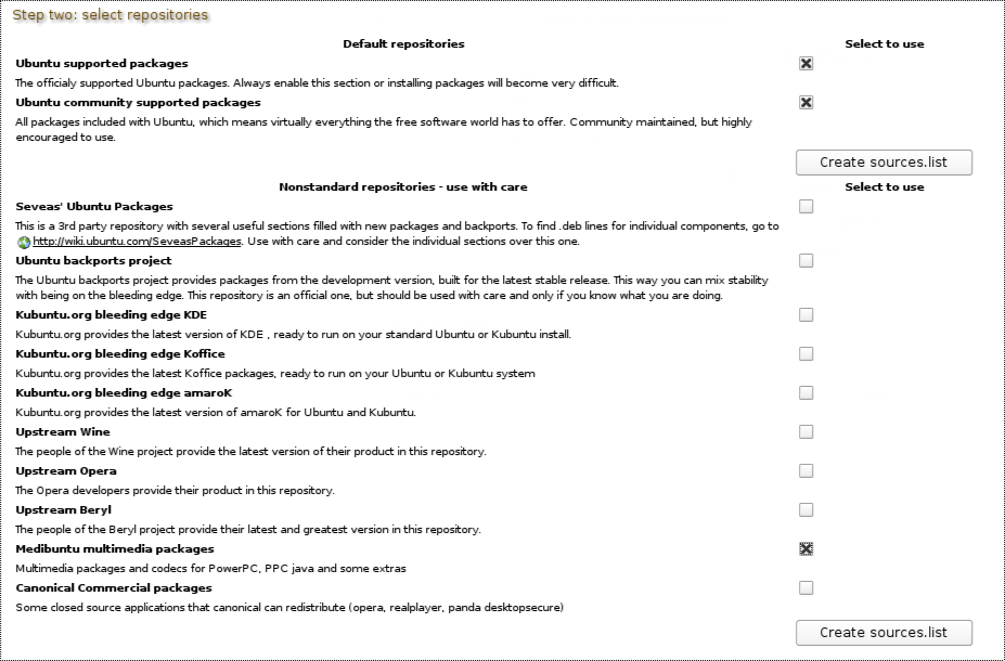

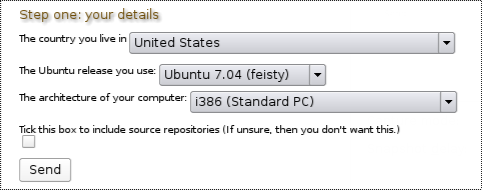

                      For clarity, I've re-written what you need to do, in the order shown and exactly as show:
                      Step 1. Go to http://www.ubuntu-nl.org/source-o-matic/ to generate a new sources.list
                      Sub-Step 1.
                      a) Select the country you live it. If not listed, choose the closest one
                      b) Select the Ubuntu release you use
                      c) Select the architecture of your computer
                      d) If you also want to include source code repositories, check the box
                      (if you don't compile your own packages, you don't need this)
                      e) Click on Send

                      a) Accept the two Default repositories (they are already selected)
                      b) Check the Medibuntu mulitimedia packages
                      c) Click the Create sources.list
                      (This will open your new sources.list in your editor. You need to make one correction to this file.)
                      d) Change medibuntu.sos-sts.com to packages.medibuntu.org

                        In step 1 sub-step 2.b I dont get what you meant this is what I get
                        Step 1
                        Sub-step 1
                        a) U.S.
                        b) 7.10 Gutsy
                        c) dont know what this is so i didnt check it
                        d) send

                          Re: Updates not working
                          For Step 1, you want what Step 1.png shows.
                          For Step 2, you want what Step 2.png shows.
                            Except you dont get that option when you get gutsy.
                            Options
                            Step two: select repositories
                            Default repositories Select to use
                            *Ubuntu supported packages
                            The officialy supported Ubuntu packages. Always enable this section or installing packages will become very difficult.
                            *Ubuntu community supported packages
                            All packages included with Ubuntu, which means virtually everything the free software world has to offer. Community maintained, but highly encouraged to use.
                            Nonstandard repositories - use with care Select to use
                            *Ubuntu backports project
                            The Ubuntu backports project provides packages from the development version, built for the latest stable release. This way you can mix stability with being on the bleeding edge. This repository is an official one, but should be used with care and only if you know what you are doing.
                            *Upstream Opera
                            The Opera developers provide their product in this repository.
                            *Upstream Beryl
                            The people of the Beryl project provide their latest and greatest version in this repository.
                              Geez! So sorry 'bout that! I'm on Feisty, and I should have 'checked' while on http://www.ubuntu-nl.org/source-o-matic/ for Gutsy. Oh well. Live and learn. :P
                              Okay, so the medibuntu repository is not available to select from on that site for Gutsy. Perform Step 1 Sub-Step a) and then go on to Step 2.
