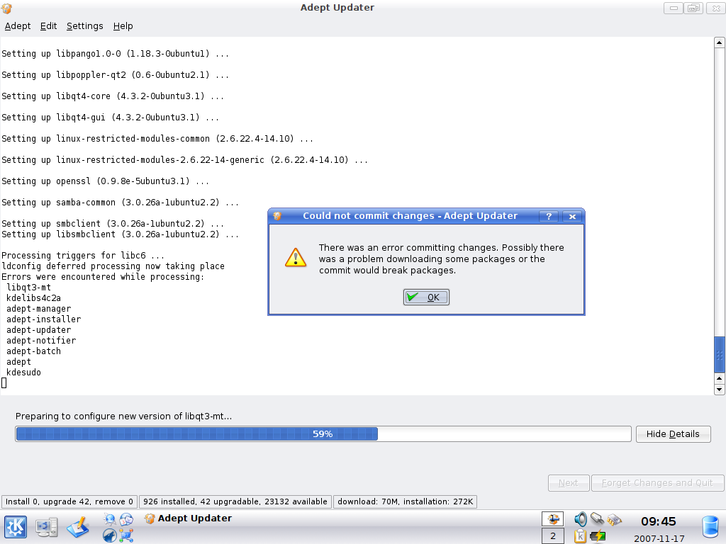

    I've just installed Gutsy on my laptop. (I had trouble with the update so I backed up the home directory and started over) I downloaded a live CD on Nov. 16th and installed from it. As soon as the install finished, I installed 3 restricted drivers (modem, wireless, and video) (very slick, by the way) and then ran the adept automatic update. download seemed to go well, but just over halfway through, I got one of the "there was an error committing changes..." messages.
    I'm not positive which info is relevant, so I've included a screenshot.

      One of the things that is happening, is Adept is attempting to update itself (not all programs deal well with being updated while running). Assuming that you had no other problems - the update process finished otherwise - you can perform the following, after closing Adept Manager.
      Open a console shell, and type the following (best to copy/paste what I've typed below):
      cd / & sudo apt-get install libqt3-mt adept-manager adept-installer adept-updater adept-notifier adept-batch adept kdesudo
      Note: The above is based on what rst posted as the packages errors were reported on. So, eddieg780, if your reported list of packages was different, you'll need to adjust the package names above accordingly.
      Enter your password when prompted and press enter. This will pull the indicated packages for installation. If you get any errors (E: message) after this finishes, copy/paste the results for review.
