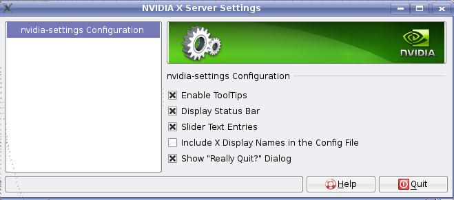

    I've installed an NVIDIA 128MB GeForece4 MX440 AGP graphics card. I used konsole to install the nvidia-glx, changed the "nv" to "nvidia" in xorg.conf, and rebooted. But when I try to configure the card there's nothing in the settings box. Konsole gave me the following error messages:
    jacatone@Dell:~$ sudo nvidia-settings
    Password:
    ERROR: NV-CONTROL extension not found on this Display.
    ERROR: Unable to determine number of NVIDIA GPUs on ':0.0'.
    ERROR: Unable to determine number of NVIDIA Frame Lock
    Devices on ':0.0'.
    ERROR: Unable to determine number of NVIDIA VCSCs on ':0.0'.
    X Error: BadDevice, invalid or uninitialized input device 154
    Major opcode: 143
    Minor opcode: 3
    Resource id: 0x0
    Failed to open device
    Major opcode: 143
    Minor opcode: 3
    Resource id: 0x0
    Anyone know how to fix this? I've also attached a jpeg of the Nvidia Settings box. Thanks.

    use the ubuntu tool to install the driver
    restricted driver manager
