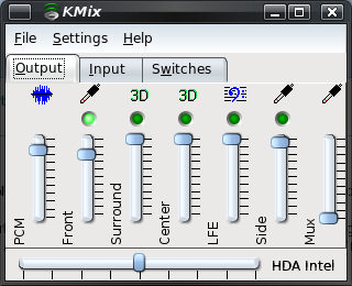

        2) K Menu | Multimedia | KMix and check that the Output isn't muted (dark green button instead of light green).

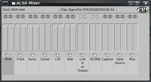

        3) K Menu | Multimedia | Alsamixergui (if it is installed) and check that the Master channel isn't muted (the speakers are white). Click to turn gray.
          Re: No sound after upgrade ! (Edgy --> Feisty)
          Hi again !
          Still no sound after checking all the steps you mentioned. I am including the screenshots.
