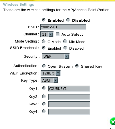

            Does your Setup look somewhat like this?(attached pic) Also, for knetworkmanager to work for me, I had to make sure no other tools were installed and the /etc/network/interfaces configured as this:

                The picture is of my DLINK wireless. The "interfaces" file is what Kubuntu uses to set up the network interfaces. The version of knetworkmanager isn't shown, but is is what ever was released with Feisty.
