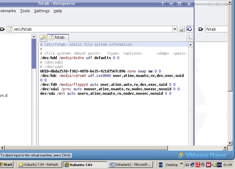

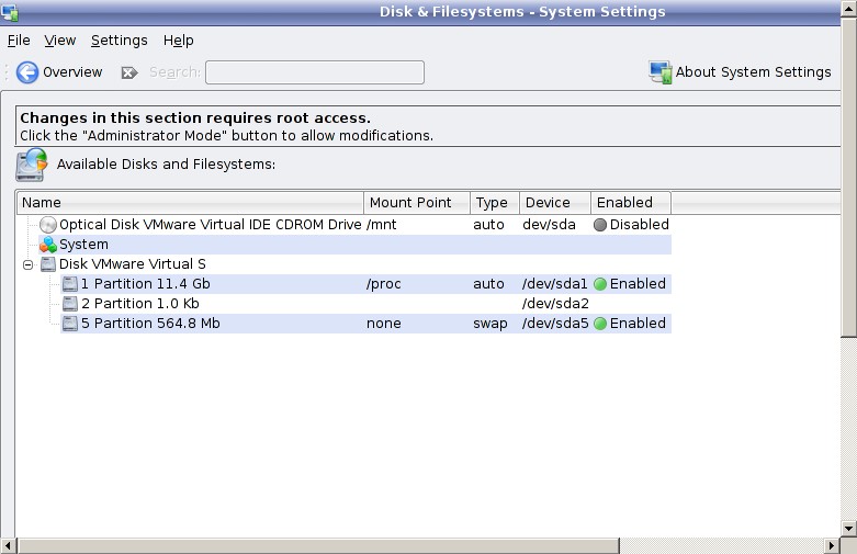

    I have Kubuntu 7.0.4 installed in Vmware player as second OS with WINXP PRO. I need to mount Windows partition and cd/dvd burner
    In root shell consol „“mount /dev/hdc“ returns „No medium Found” and “mount cdrom” returns “cant find cdrom in etc/fstab or….”
    Can somebody please check my Fstab file, I think the problem lies here, but Im brand new to Linux and would appreciate any help.

    For the Windows partition, you don't have one. As far as VM is concerned you only have one OS. You could access via the network through samba.
    Have you enabled the cd drive in the player so that it's available to the guest OS?

      Ive now solved CD problem (something dumb that I overlooked in Virtual player).
