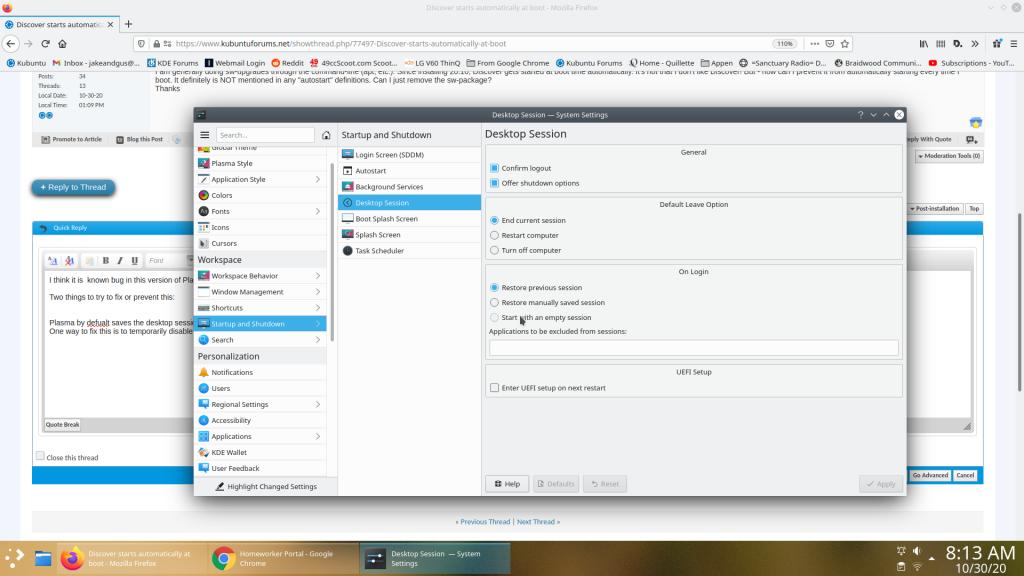

    I think it is known bug in this version of Plasma, else it is 'stuck' in the saved desktop session.
    Two things to try to fix or prevent this:
    Plasma by default saves the desktop session when logging out, and once in a great while a program will get stuck in the saved session and open at login, even if it it was not open when the user logs off.
    One way to fix this is to temporarily use the 'Start with an empty session' option, and log in without a saved session once, to clear things out.

    The other thing is to blacklist Discover (plasma-discover) as shown below. This may be the solution at the moment, if you are seeing the bug as opposed to the corrupted saved session.

      I think I will try your second suggestion. Let's see whether it helps... Thanks for trying to help.
        It should work, it did for me, and others
          Blacklisting plasma-discover and starting with an empty session solved this issue. Thanks!
