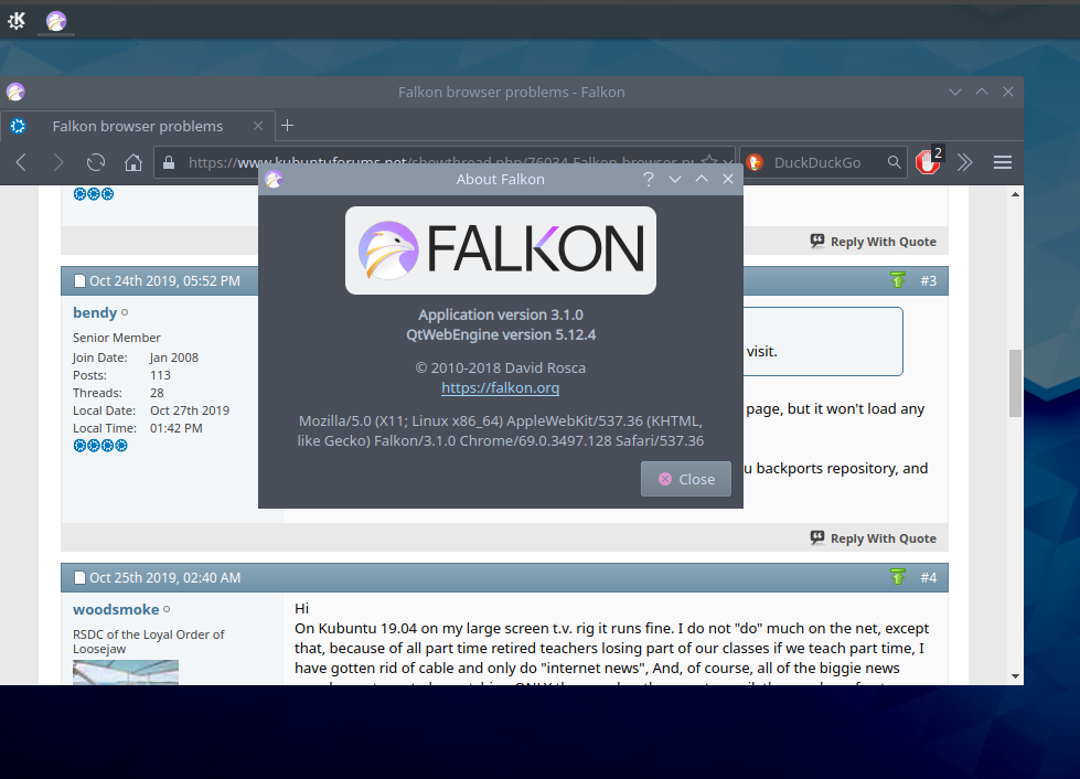

                Seems to be working just fine here on Kubuntu 19.10 with kubuntu-backports enabled:
                Kubuntu 20.04
                  Hmmm. What graphics are you running - intel, nvidia, AMD?
