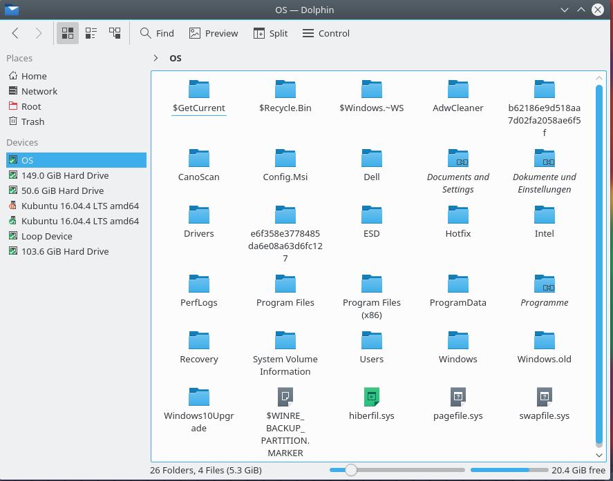

                              I booted with a live USB and uploaded the content of the partitions in this post and the following one. Some are not readable.
                              OS which seems to be a part of Windows.

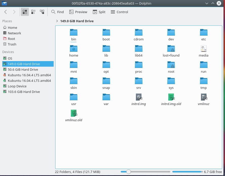

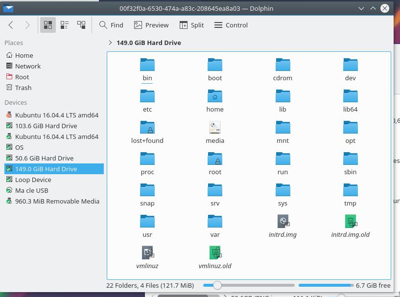

                              149GB wich is sda7 and readable.

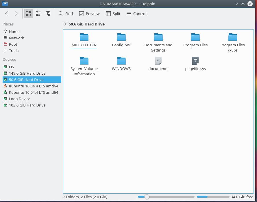

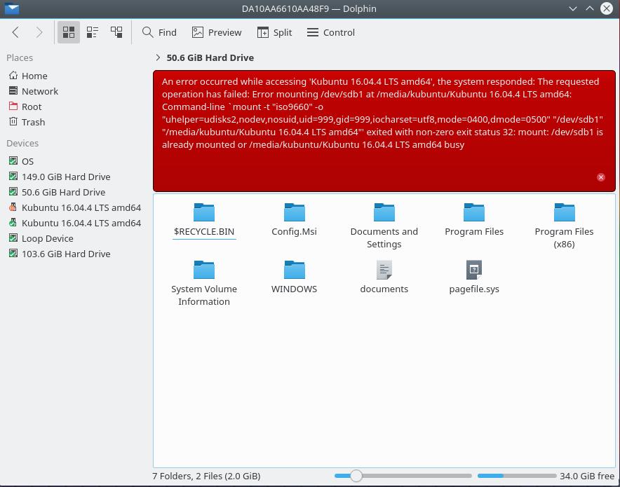

                              50,6GB wich seems to be a part of Windows

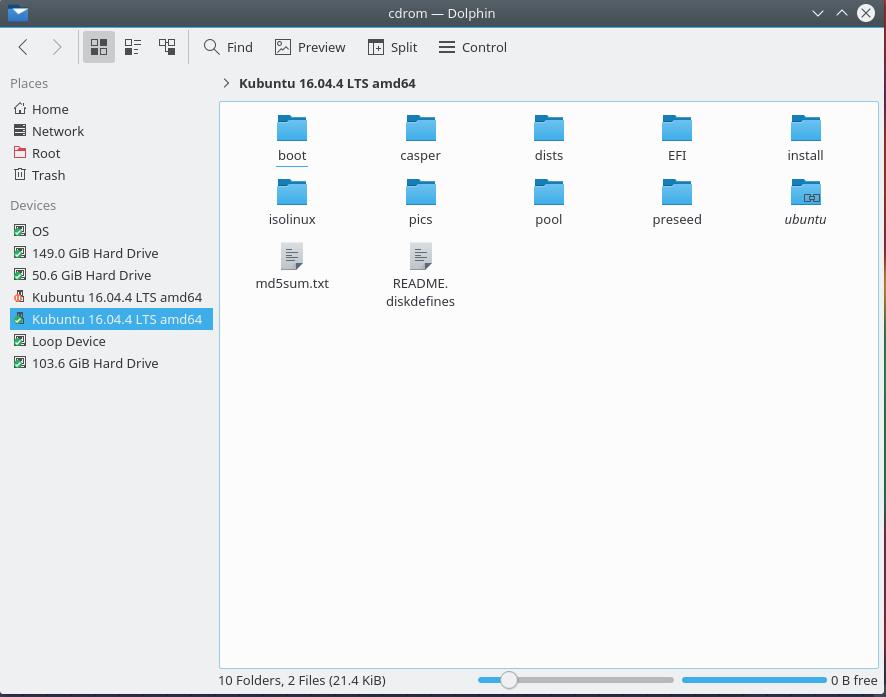

                              unreadable Kubuntu 16.04
Name:	red Kubuntu 16.jpeg
                              I can't get rid of the following image that you can forget.
                                #30
Name:	green Kubuntu 16.jpeg

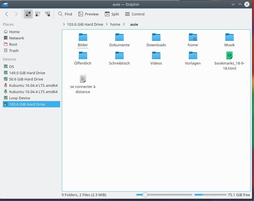

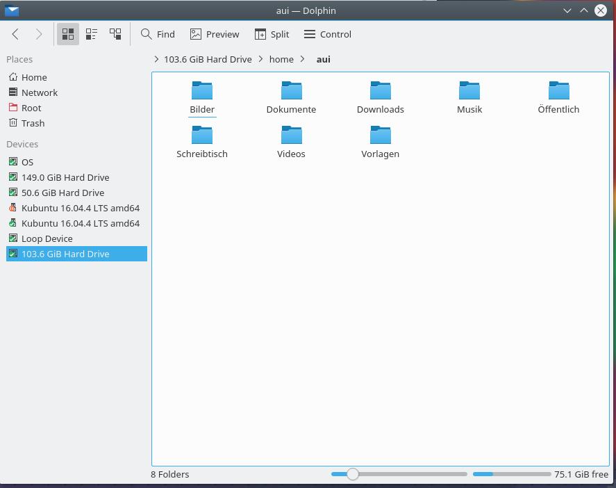

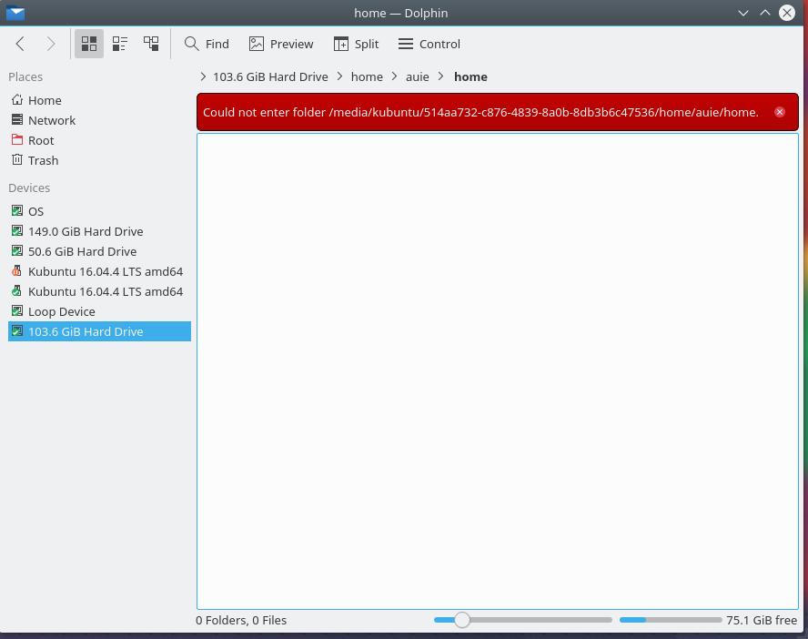

                                For the last 103,6GB partition, I show the homes of the two users aui and auie and the unreadable home in auie's home.
                                aui's home
Name:	103komma6 aui s home.jpeg
                                auie's home
Name:	103komma6 auie s home.jpeg
                                The unreadable home in auie's home
Name:	home of 103komma6 auie s home.jpeg
