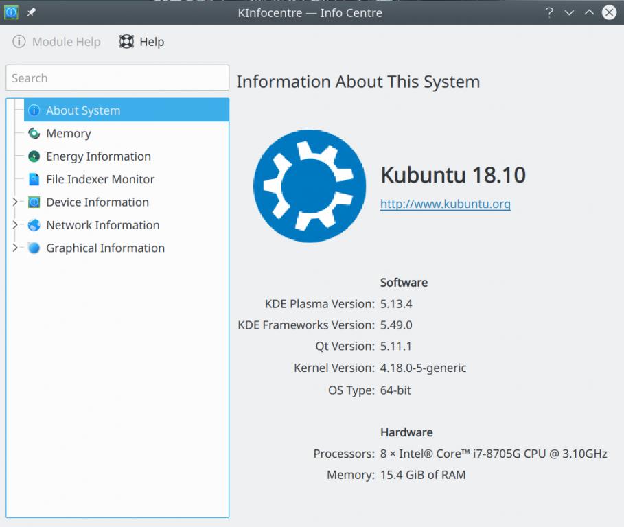

    My current system status is shown in the graphic below.

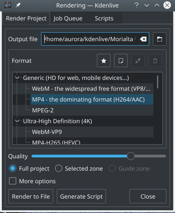

          I render to an mp4 file and the render that I use is shown below.

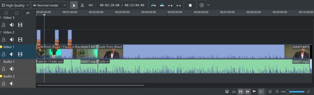

          A section of the video that I am rendering is shown below.
