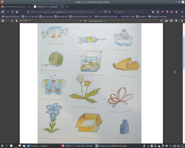

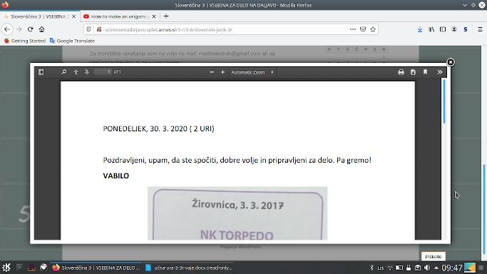

    We are doing schooling from home, and i can't figure out why PDFs open in window rather than inside the browser. This happens both in Chromium and Firefox. What setting is doing this? I am attaching a screenshot of windowed PDF as opposed to what i see on my desktop PC (where it gets opened inside the browser).
    My work around is to save them first, then open them in Okular, but for kids it is easier if it open in browser and if they can switch between tabs as they look up at the instructions. two of them have to share one small laptop on large kitchen desk, as we were just in the process of remodelling our desktop tables to provide more space for writing when the virus limitations struck.

    I see what you see in the LOWER image.

      but i was thinking that maybe it is scripted (or defaulted) on the page to open in a new window. I've noticed that i am blocking some scripts on one PC the other day. It looks like i need to do some testing. But today i had to go to work at the office, so this will have to wait at least until i get home.
      cause i find it strange that it does this on chromium as well. pops up the same kind of window.

          looks like the have it made in a way that PDF is opening in new (popup) windows. not sure how or why they've made it like that. but i guess they are self taught web designers.
          using noscript script blocker addon in Firefox it blocks this behaviour and the PDF is opened in new tab and inside Firefox. a work around and is working quite well. the boys are now able to share the screen better and almost no printing is necessary. productivity is through the roof!!! * not really, i mean who can be productive with all the toys lying around and all those Steam & GOG games available in next room.
