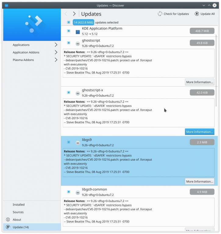

                Assuming you are on 18.04, you should not be getting bombarded with updates all that often, unless you have added a third party repo that updates constantly - one of the popular driver PPAs has them at least once a day by design, for example.
                As an LTS release, you are getting security updates mostly, and the way Linux breaks things down into small components, you usually only need these tiny bits instead of the whole shebang - look at the file sizes every now and again and you will often see them in the Kb ranges. They are in no way petty.
                You of course can disable notifications, and there are how-toooo's allover the net on disabling how often *bunut checks for them in the background - in the 'Sources' option in Discover, or use the search function in the Kmenu to look for 'software sources' you can adjust the interval.
