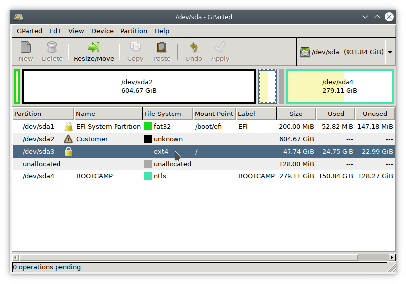

        That isn't right. The partition type should be showing as ext4 (assuming that was the FS you chose; it's the 'default' choice). This was a working -- "I could boot into it Kubuntu" before this mishap?
          I'm actually responding from Kubuntu right now! It was definitely an issue with the damned google chrome remote desktop .deb install. It was starting a desktop session on startup, I believe. I was able to kill it using htop and uninstall anything chrome-related. I then restarted sddm (sudo service sddm restart), logged in, and my desktop showed up! Which is where I'm at now. Not sure if this will last a reboot. Will have to report back.
          Question: Does plasma allow two desktop 'sessions' to be ran at once? Maybe X server doesn't... or KDE for that matter. No idea.
          But yes, I thought that was very strange, as well. I have no idea why fdisk is reading it that way, but everything is working on my end. Here's a shot of Gparted, showing ext4.

          Success! So it just looks like the Google Chrome Remote Desktop package doesn't exactly play nice with Kubuntu 18.04. For what it's worth, I had it working for a while, and was able to connect remotely from my phone during tests, which was nice! But after a reboot I guess it created a discrepancy, or something. I used apt-cache search chrome to find the chrome-remote-desktop-beta .deb package I had installed from the link I provided in my first post, and removed it. Also removed Google Chrome for good measure.
          Everything seems to be sorted, now. Time to make a partition image with dd, haha.
