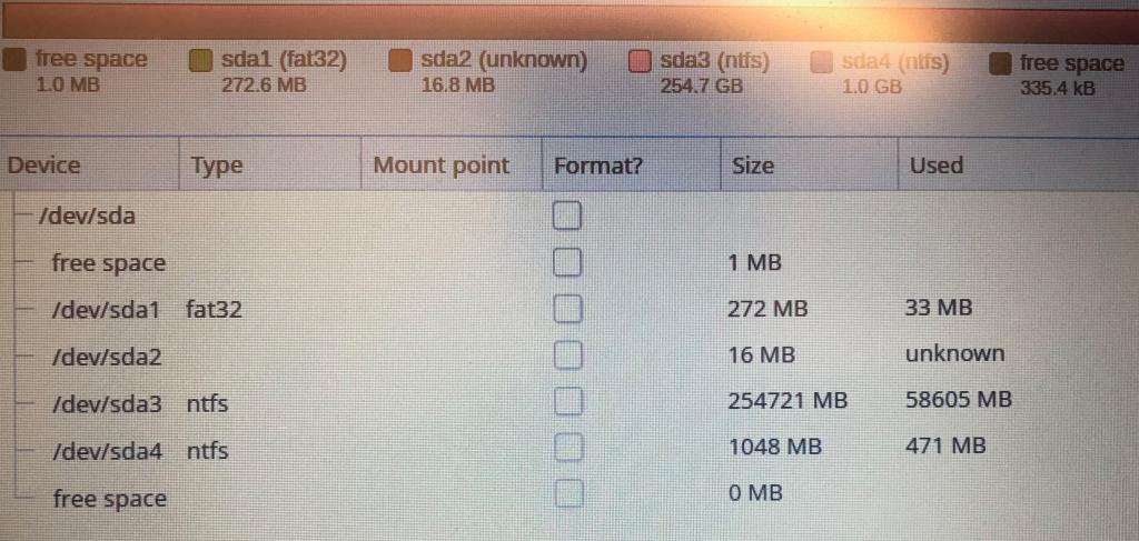

                      Here's a hillbilly screen shot of the existing Windows partitions as seen by Kubuntu set up.

                        Here's a screen "capture" of the x260 Windows partitions as seen by Kubuntu setup.

                          See, your /dev/sda1 is your EFI partition. Only 33 MB used. Mine uses 6.8 MB, and I have six distros on HD. So a quarter gig is plenty.
                          Just make it FAT32 and give it /boot/efi as mount point.
                          Then, assuming your RAM is 16GB, make a swap one say, 20G.
                          The rest can go on an EXT4/BTRFS one as big as what's left (mount point /).
                          Or you can split the rest up between / (root) and /home. And set the corresponding mount points.
                          This is useful in case you re-install the system, so nothing in /home is wiped, and your settings and documents are preserved.
