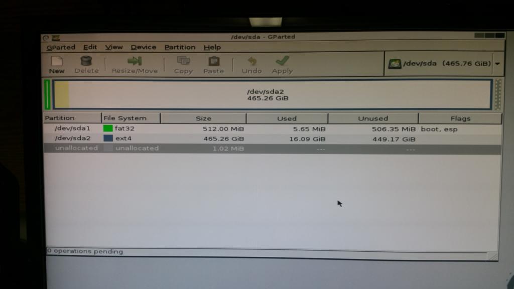

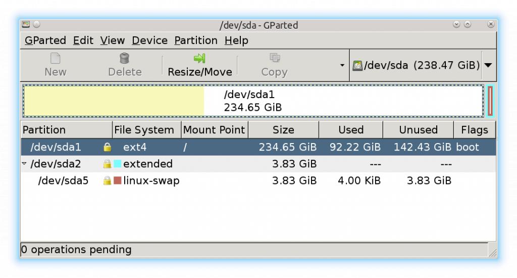

                  Greygeek:
                  OK, the NEW SSD is indeed formatted for UEFI boot, and the flag is set. See attached picture. The second picture is a screenshot from the 14.04 SSD, which is formatted Legacy, it would appear.
                  BIOS on the machine is set to Auto, which says it will boot from either. However, that is not happening.
                  Man, what I had to do to even get GParted to boot! I have a 4K monitor on this machine connected HDMI. I finally figured out that I had to boot it in safe mode to get it to work... (after connecting an older VGA monitor, and trying that in both digital and analog outputs...)
                  Anyway, back to you.
                    I just came in on this, only quickly skimmed the posts, not sure what a "solution" will be, but in my opinion Frank616, it is not good practice to mix things: looks like you have UEFI booting mixed with Legacy/MBR booting; and GPT mixed with MBR. Rod Smith is the expert on "exotic" booting configurations, and I'm gonna guess he would adamantly advise against this kind of mix up. Just a sample of such issues and his thinking (on his extensive site):
                    https://www.rodsbooks.com/gdisk/bios.html
                    http://www.rodsbooks.com/efi-bootloa...-bad-ugly.html
                    I realize this post is not helpful, but it's getting late here. In the other thread that you mentioned about similar problem, I posted some ideas including what can be done from live Kubuntu USBs/DVDs, like making a rEFInd CD (Rod Smith is the author of that) ... but, that would mainly be useful for UEFI booting only. You can also re-install GRUB from a live USB/DVD (links are given in that other thread), or make a Boot repair CD (in a live session) and use that. Of course, this all assumes you can boot your BIOS/firmware to the live USB/DVD, which I notice you did boot the gparted. As I say, this is not helping much.
                    Btw, this message:
                    "The 'grub-efi-amd64-signed' package failed to install into /target/. Without the GRUB boot loader, the installed system will not boot."
                    That usually means that the installation can not see the ESP you intend to use for GRUB in a UEFI installation. I see an ESP, sda1, on your first attached screen shot, for example.
                      I think this happens if there is no internet connection available and/or enabling updates during the install, though the package is on the disk, I think. (Or if there is no efi partition when setting things up) manually
                      https://bugs.launchpad.net/ubuntu/+s...d/+bug/1780897
                      https://bugs.launchpad.net/ubuntu/+s...2/+bug/1778848
                      https://bugs.launchpad.net/ubuntu/+s...r/+bug/1767508
                      among many others
                      Are you using the 18.04, or the 18.04.1 iso? It is here, just in case the fixes have made it to the new iso:
                      http://cdimage.ubuntu.com/kubuntu/re...ktop-amd64.iso
