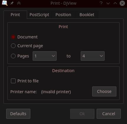

                    Under DjView there is Printer name: (invalid printer),
                    and if I try to click on Choose and choose my printer from dialog box, after accepting , it remains same (invalid printer)
