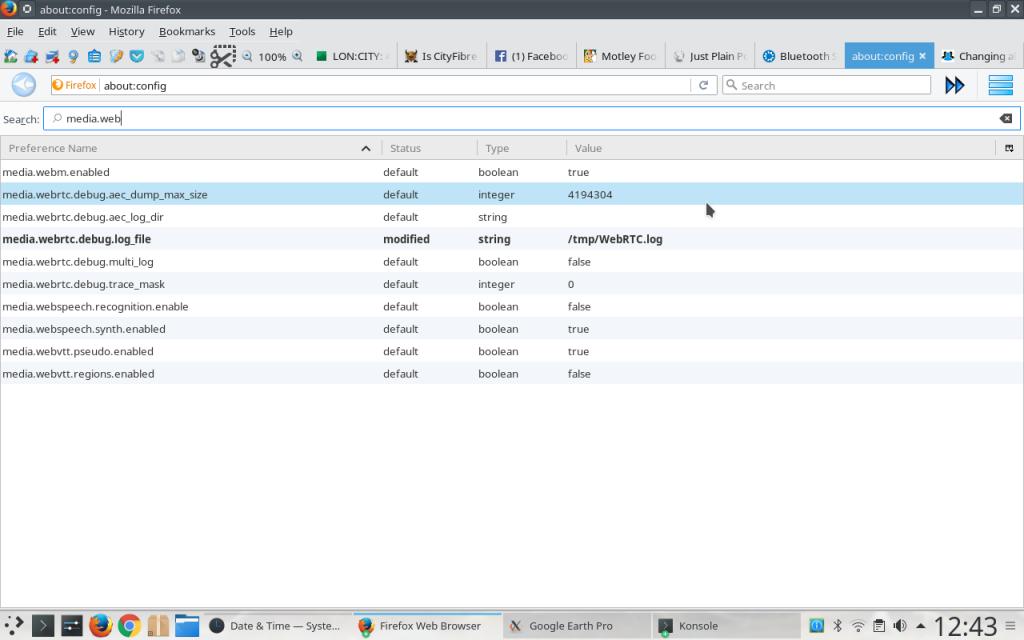

          Assuming you are using FireFox, in the URL enter "about:config" and search for
          media.webaudio.enabled
          and make sure it is set to true.
          May already be set to true but at least it is a shot.

            I looked for that but it doesn't exist, I am using Firefox 56 (64 bit). I hasten to add that it doesn't work with Chrome either.

              You can add it as a Boolean. If it doesn’t help (reboot FF) then delete it
                Tried that, but no joy.

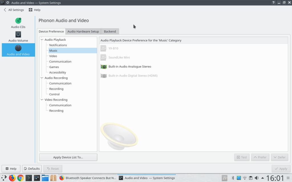

                            I actually managed to get two different Bluetooth speakers to connect and play test sounds. However now both of them are grayed out in Audio and Video system settings. I can't connect and more importantly I can't delete them and try again.
