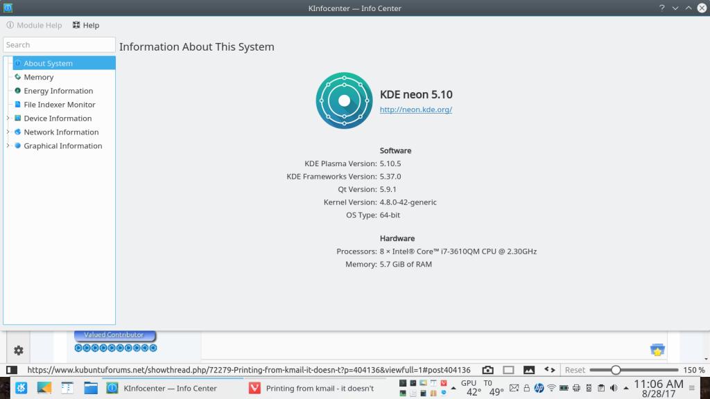

        As you can see, My Neon is definitely not on 5.9
        My post was to point out that the KMail printing problem isn't universal, since KMail2 printing on 5.10 works great. I think the problem isn't with KMail but with the printer configuration or a setting in the System Settings.
          GG, right there in your screenshot it says "Qt Version: 5.9.1"
            The problem occurs with Qt Version: 5.7.1
              That's Qt, not Plasma or Frameworks. Applications are built on Plasma and Frameworks modules.
