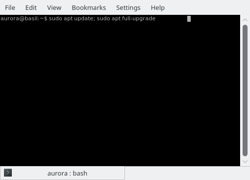

    On a fresh install for Yakkety, I found that the cursor location is about a tab stop to the right of the correct location for entering and deleting text.
    I have purged konsole and konsole-kpart from my system and also deleted the file .local/share/konsole. Even after doing all this and installing konsole again, the problem remains. The graphic below illustrates what I am seeing.

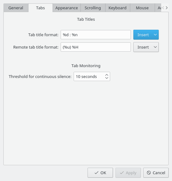

      What are your settings on the "Tab" bar? Mine are %n : %d and (%u) (%H)
        The tabs that I have from the Settings > Configure Konsole > Edit Profiles > Tabs is shown below:
        I think it is similar to yours if I have the same menu as you.
