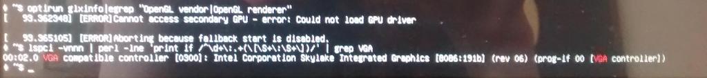

            Am I right in assuming that Kubuntu is bypassing the integrated mobo GPU and trying to activate the Nivida chip and not the mobo GPU?
            Actually it appears to be doing the opposite - unable, or refusing, to access the nvidia GPU. I took the following steps just now to try to prove this - they may mean something else entirely though:
            1. reinstalled bumblebee-nvidia and nvidia-361 packages
            2. disabled nouveau and restarted bumblebeed as per your instructions above
            3. rebooted
            4. got a completely black screen and no splash/login after boot (this is what happened every other time i tried to install the proprietary driver)
            5. brought up a command line with ctrl-alt-f1 and ran commands to see what GPU was in use:
            Hmmm. It's still using the integrated GPU, and it's saying it can't access the nvidia one cause it can't load the driver?!
