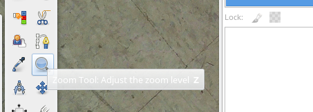

        I have my Gtk styles set to oxygen-gtk for Gtk2, and Orion for gtk3
        Here are my tooltips

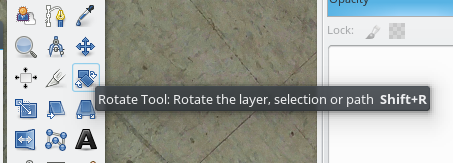

        And setting Gtk2 to Orion:

        You have to restart the application to see any changes made.
        What color scheme are you using, if not the default Breeze?

          I have reset the theme to Breeze and selected the same Gtk styles that you cited and all is now well.

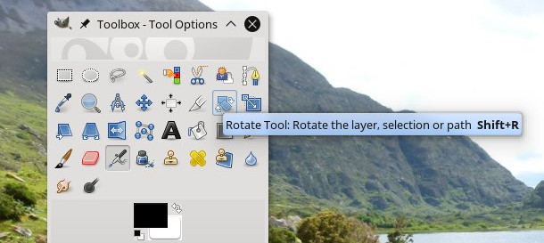

            Thanks for all the guidance on how to make Gimp Tool-tips more visible. As I prefer the Oxygen look with sculptured buttons, I decided to see how well it worked if I stayed with Oxygen instead of changing to Breeze.
            So I did the following: System Settings > Application Style > Gnome Application (GTK) GTK2 and GTK3 Themes I set to oxygen-gtk. This results in sculptured tips as shown below.
