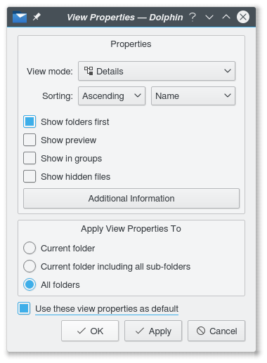

    Select "View/Adjust View Properties"
    Set it up like this:
    View mode: Details
    Apply View Properties To: All Folders
    Use these view properties as default: Enable this option
    That should do it

        That's odd because from where I'm sitting, I can see those options.
        See attached screenshot .....

          Whether the lower part of the view properties dialog are shown or not depends on whether dolphin is set (Settings>ConfigureDolphin>General) to remember folder view properties independently ("Apply View Properties" shown) or to use common settings for all folders ("Apply View Properties" not shown, redundant).

            Thanks kubicle and bitzbox. The moment I changed General to 'Remember properties for each folder' it changed to 'Details' view, which was where I left 'Adjust View Properties'.
