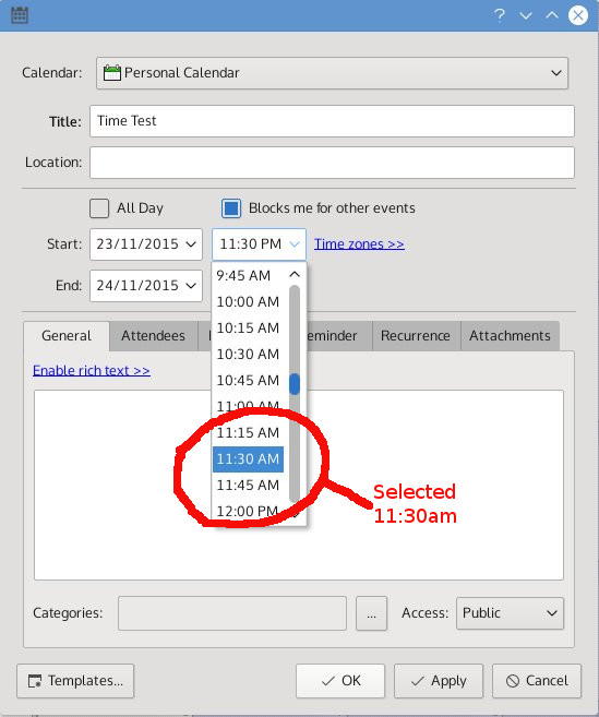

        I thought that I should illustrate my problems with Kontact graphically. My problems are with the Calendar, and when I select a new event for say 11:30am as shown below,

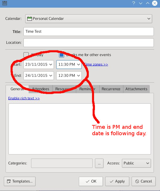

        I then get the time as 11:30pm and the end time 1 hour later is for the following day. This makes the event go for just over 2 days as shown below:
        I normally use my calendar file std.ics, but for these tests I used the "Personal Calendar". Both calendars behave the same.
