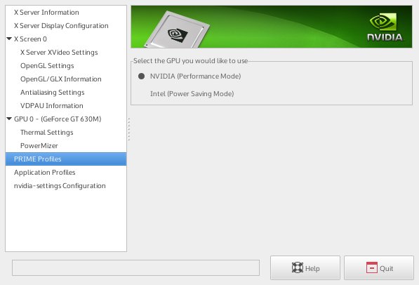

                    Sounds like you have two video cards like I have. I assume that you have successfully installed the NVIDIA driver which allows you to select either the VGA or the NVIDIA cards. On my system I get the following option from running Settings > NVIDIA X Server Settings.

                      Thanks NoWorries, but the problem continues for me after doing that. I don't know if I should remove the .cache folder.
