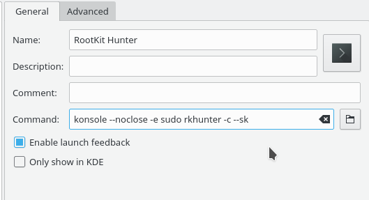

                If you want to launch them from the application menu, right click the launcher button and click "edit applications". Select the menu you want to put the application in ("Utilities" is as good as any) and press the "New Item" Button at the top.
                For rkhunter, fill the fields in like so:
Name:	add application.png
                To explain the command section. "konsole" is telling to open the konsole program. "--noclose" is telling the program not to close when it is finished running the script (so you can read the results), "--e" is telling konsole to execute the following command. "sudo rkhunter" is the command to open the program with root privileges. "-c" is the command to run the check" and "--sk" stops the enter prompt after every test and just runs it in full to the end. The last bit (--sk) is personal preference, delete it if you like it the other way. There are list of the options you can use in the man pages listed above but usually typing -h after any program name also lists them e.g. sudo rkhunter -h
                When your done, click save and it should be the application menu. When you click it, a Konsole will open, ask for your password and then run the program.
                For chkrootkit, the procedures is the same except in the "command" field, you would put
                konsole --noclose -e sudo chkrootkit
                and name it differently.
