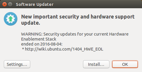

    I've been seeing the following message for some time now, what I don't understand is if Ubuntu 14.04 LTS means that it is (supposed to be) supported for 5 years then why end some updates as highlighted in the image?
    If Ubuntu has stopped supporting some elements of an LTS then is really "long term support"?

    14.04 is an LTS and supported until 2019 ,,,, IF you keep up the HWE ,,,,,,,,,,see https://wiki.ubuntu.com/Kernel/LTSEn...Kernel_Support
      And https://wiki.ubuntu.com/1404_HWE_EOL
      Basically enable the Xenial HWE stack for 14.0r to keep getting kernel and driver support. All other software is still supported till 2019

        Hummm ,,,,wile your link dose give more info on it ,,,,,,mine dose give a one liner install that can be copy pasted into the terminal to get it for 14.04 .

          Yeah, I was looking at this during my break and had collected some links, this one was from the warning pop-up so I figured I'd add it for informational purposes.
          It isn't totally clear if I'm right or not here but it seems that 14.04.0/1404.1 itself is LTS but once newer point releases are pushed out ( which have an HWE enabled by default) the kernels and related drivers have limited lifespans if the particular Ubuntu release the HWE is from is EOL.

            yes I think thats correct ,,,,,,from what I've read
