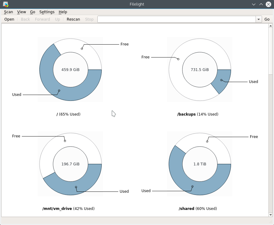

            Incorrect. The filelight screenshot below and the df -h output are both captured simultaneously from an actual Kubuntu install. It seems likely some kind of bug in how df computes disk usage in a dynamically allocated virtual drive.
            stuart@office:~$ df -h
            Filesystem         Size  Used Avail Use% Mounted on
            /dev/sdg3          460G  301G  158G  66% /
            server:/           1.9T  1.1T  741G  61% /shared
            /dev/sda2          197G   74G  114G  40% /mnt/vm_drive
            /dev/sda3          732G  105G  627G  15% /backups
            Seriously, if you're looking for answers, it's better not to come to conclusions before gathering all the evidence. Obviously, something is going wrong on your end, but making pronouncements isn't going to help.
