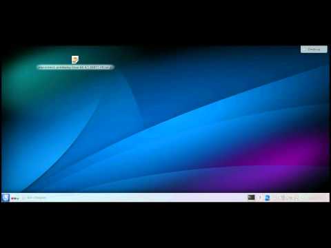

                  I think we are missing the important bit here - the ethernet connection is not working, which is why you can't connect to the VPN. When you get the yellow question mark on your networking icon, when you click it, you should see something similar to "wired connection1 ". Now, hover your mouse over it and then click the 'connect' button that you should see, and see if that works. If so, you can then connect to the VPN using the cisco program or adding a new openconnect in your connection manager
                  Dang I forgot that virtualbox recording does not include the mouse without fiddling ;(
                    claydoh, I believe his problem is that he does not see the wired connection so he cannot simply click connect. I think he needs to add a wired connection as you showed toward the last of your video. (Restrict to eth0 which is the listed device). After adding the device he may be able to connect immediately or may need to reboot. By the way, open-connect is the way to go if possible. I use it daily.
